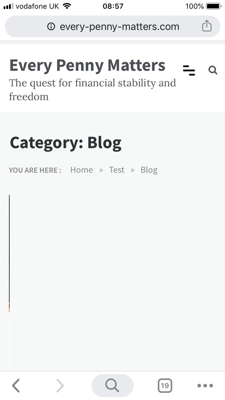

    I would really appreciate your help with some issues I am facing when using BoldGrid Post & Page Builder. Specifically,
    1) When BoldGrid Post & Page Builder is activated, the blog page can no longer be viewed on mobile (it is fine on tablets and desktop)

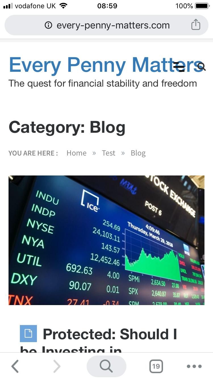

    I thought I’d add some pictures to illustrate the issues! Many thanks 🙂

    Hi JT,
    Sorry to hear about the styling problems on your website and our team will do everything we can to get this working for you.
    It looks like the theme you are using bases a lot of its blog styles off of the Bootstrap framework which is causing some conflicts with the Post and Page Builder since it uses Bootstrap as well to handle responsive styling.
    One solution I have for this is to use custom CSS to address these style conflicts and the following code snippets that should fix this problem.
    @media (max-width: 991px) {
    .archive.category #masonry-loop article {
    position: relative !important;
    top: 0 !important;
    left: 0 !important;
    width: 100%;
        .archive.category #masonry-loop {
    height: unset !important;
    I hope that this code works for you and please let us know if there is anything else that we can do to assist you, we are always happy to help!

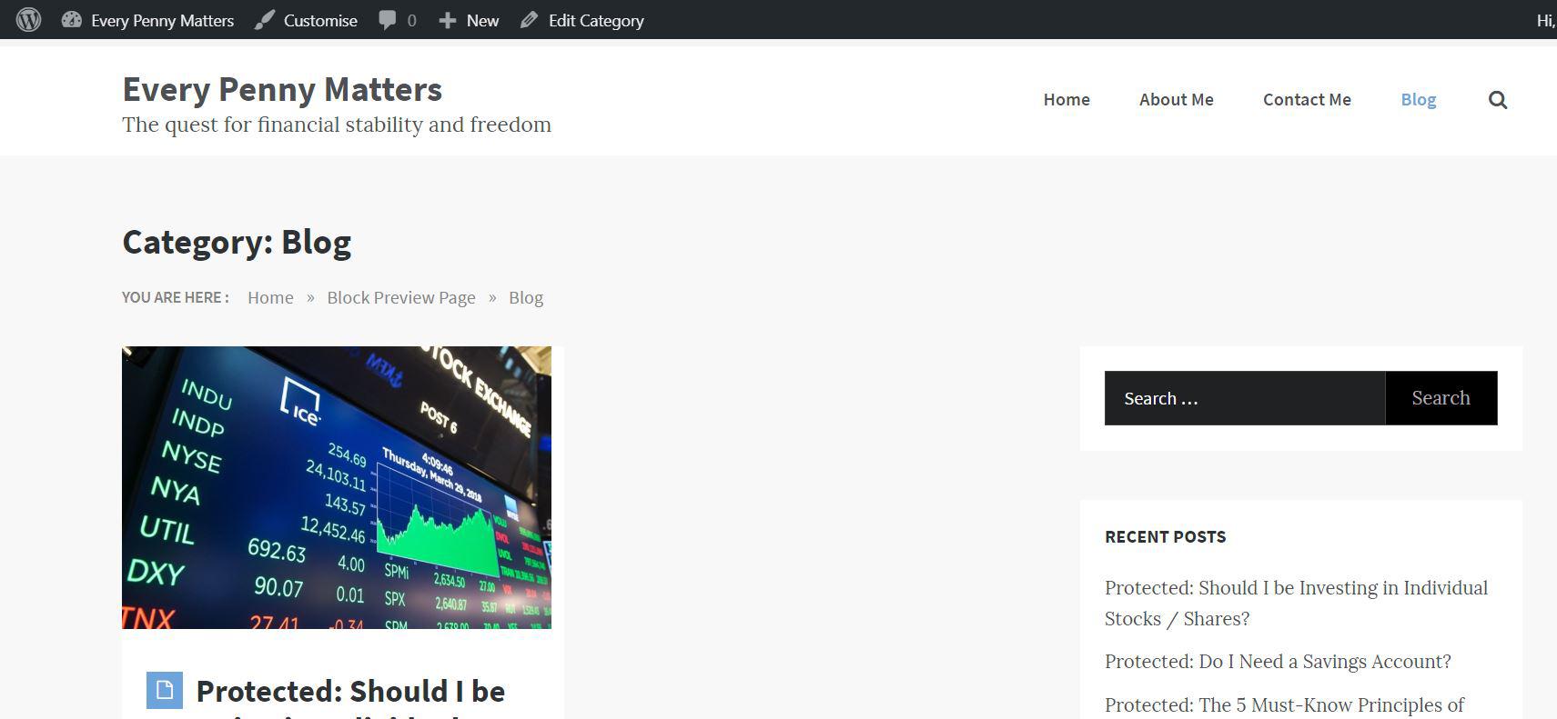

    Thank you so much BoldGrid Support Team, really appreciate it! I just realised I’ve found one other small styling issue with the blog page. I’ve selected masonry view and optimally the posts should appear as two columns. At the moment however it only appears as a single column and there’s a gap in the middle of the page where the second column should be (I’ve attached a screenshot). This is only a problem for the desktop top view (and not an issue for mobile and tablet).
    Again, thank you so much for your help in advance! Last issue (for now!) hopefully!

    #30462
    JT890
    Oh apologies! The issue seems to have sorted itself out now. Sorry for the hassle! Have a great week ahead 🙂
