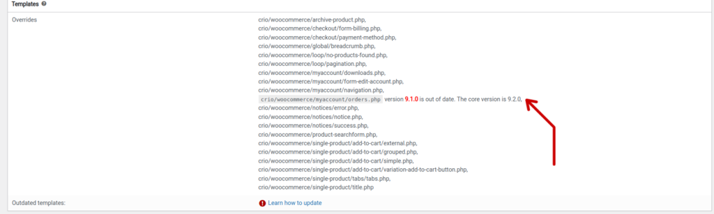

    Looking further into it it only seems to be one template in question so there’s definitely no need to worry here. The template file looks to be an order form and it’s only one version out of date:
    crio/woocommerce/myaccount/orders.php version 9.1.0 is out of date. The core version is 9.2.0,
    WooCommerce Template-orders
    I’ve created a bug request on GitHub on your behalf so that you can track the issue’s status and report further concerns. Please let us know if there’s anything else that we can answer for you!
