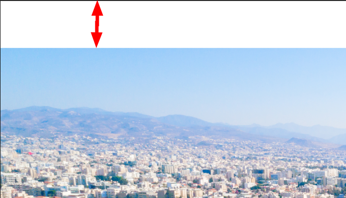

First, I’d recommend editing your source image to remove this white gap at the top of the image:

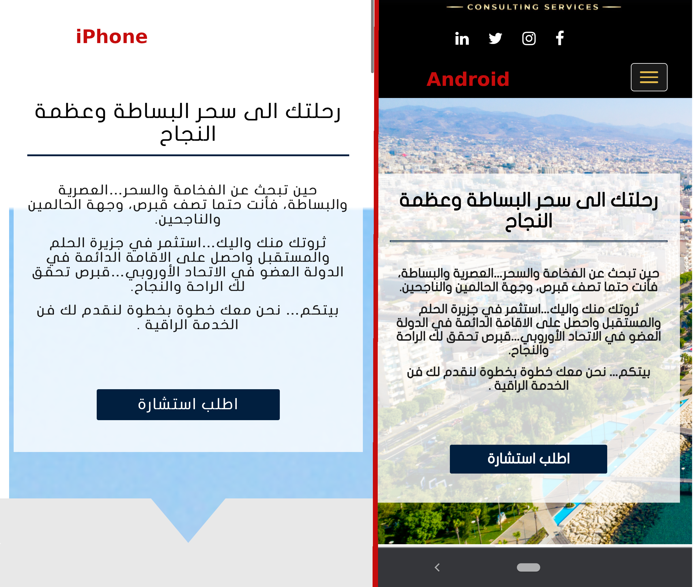

.Next, one reason you’ve found a few different answers for different people trying to solve this issue is that iPhone’s Safari in particular does not support the “Cover Page” size very well, and different CSS tricks work best for different individual images.
The technical reason for that is because iOS Safari uses the full height of the entire webpage to determine the “cover” size, rather than the height of the phone’s viewport, which results in the background image looking extremely zoomed-in. You can see the difference side-by-side here:
My favorite solution for this tricky issue so far is the following Custom CSS, which makes sure that the image is the right size on mobile devices, as well as centered:
@media (max-width: 991px) { body.custom-background { background-size: auto !important; max-height: 100vh; background-position: center top !important; } }By using the max-height: 100vh; rule, we make sure the image stays at 100% of the “View-height.”
