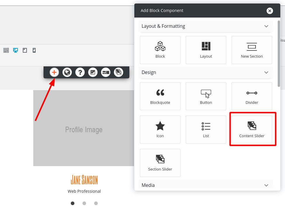

    To find it, hit the Add Block Component (+) button, and look for the content slider option.
    Add content slider block component

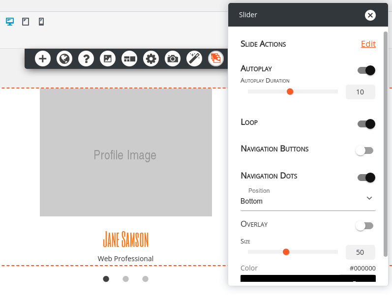

    This will give you a lot more flexibility. You can add captions or other content, control the look and feel of the navigation controls, and yes, adjust the autoplay duration:
    Content slider options
