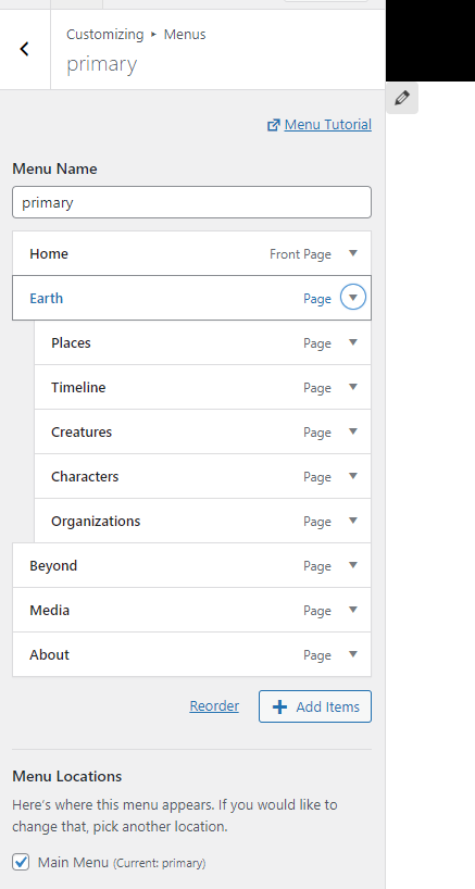

    As the title suggests, one of my pages is for some reason stuck on the post page-format, no matter what I try. I’ve done the basics like here https://www.inmotionhosting.com/support/edu/wordpress/remove-blog-page/, but for example the menu still says that it’s a normal page, not a post page.

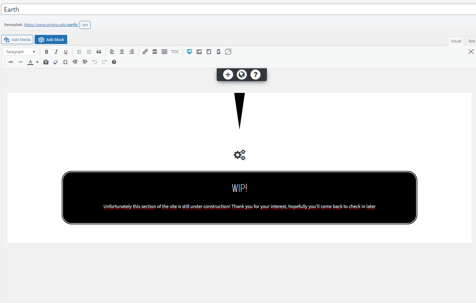

    This is how the page should look like:

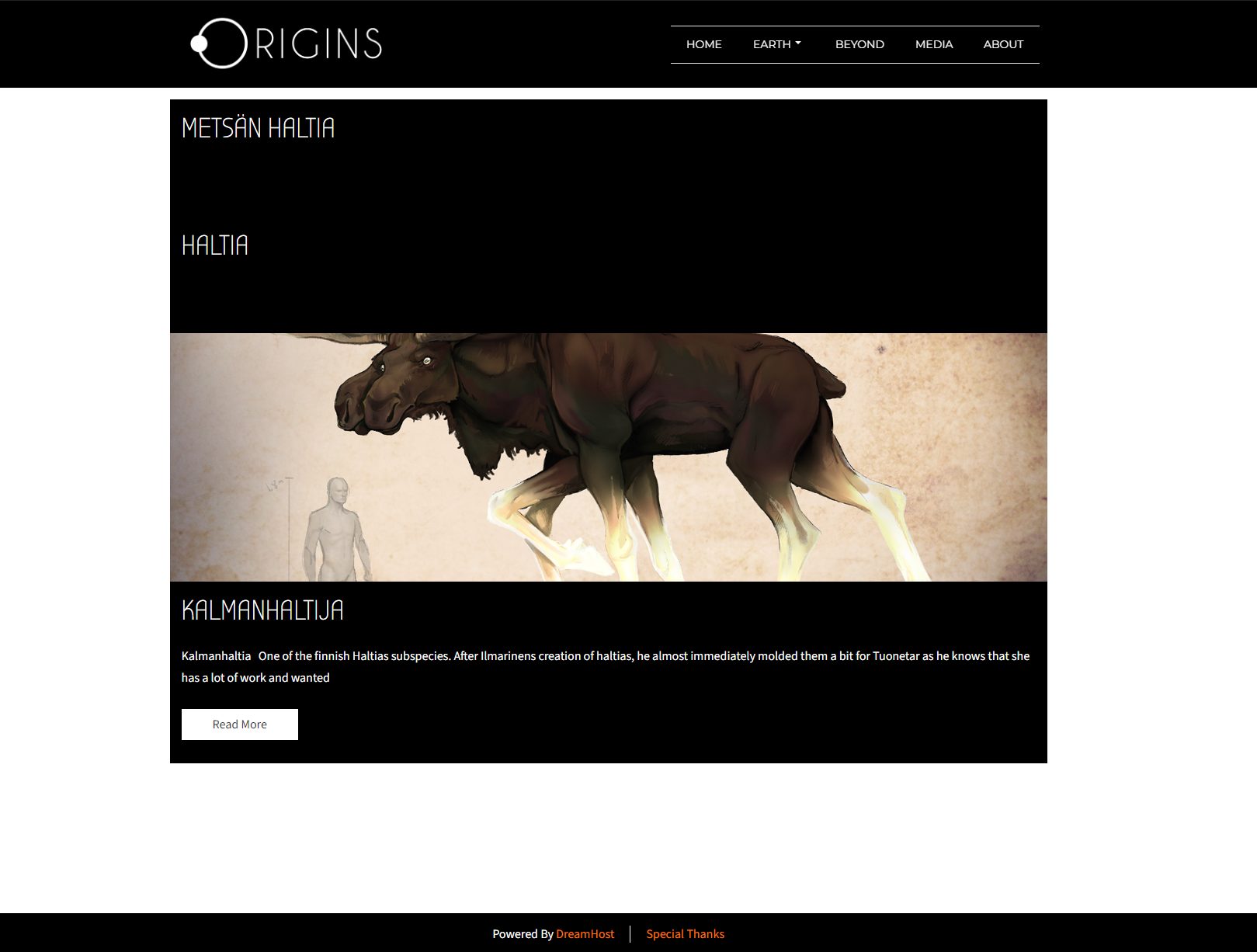

    And this is how it actually looks like.
    The three posts show up correctly, as I’ve presented them as a test on the ‘creatures’-page. But I can’t get them out of the ‘earth’ page.

    I took a look at your page and in the source code it is actually indicating that it is a category archive:
    Based on what we are seeing here, it seems that you have  a Post category the use the slug earth and that seems to be what’s displaying. Would you be able to check the Category base field in your Permalink settings? Normally a category page would show up under  https://yourdomain.tld/category/earth/ but if you have  a . in the Category base field in your permalink settings the category and the page may be sharing the same slug.
